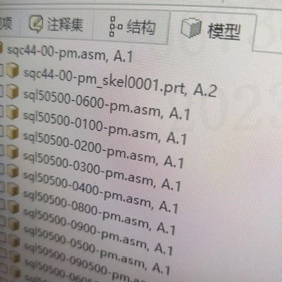

Hello, Would anyone know how to show the part number in the creo view,
My creo view only show filename and vision number (I open the view from windchill web page).
Most time I need the item number to check the ERP information,
But now, I need back to Windchill web page check item number first.
Is there any option for me can select show the inforamtion?

You can configure attribute columns in Creo View referring which will display attributes associated with attribute of each component. Ideally you part number shall be part of attribute in for each component which you can also view in Attribute panel in Creo View.
Refer To Configure Attribute Columns in the Structure Tree Display (ptc.com) for more details

@vdegaonkar  Thanks very much, That is what i was looking for!😀
