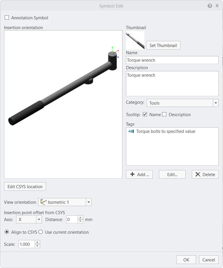

I added a Torque Wrench to my animation.
And, when I preview it, it generates the text "Torque bolts to specified value".
This is because I added the Torque Wrench.
Is there any way to remove the other phrase, leaving only "Step 3"???
agarland
September 8, 2023

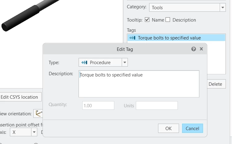

You need to edit your symbol to remove the procedure tag that has that text.
This can be done in the admin tool.
You could also edit the tag to change the text that gets displayed.

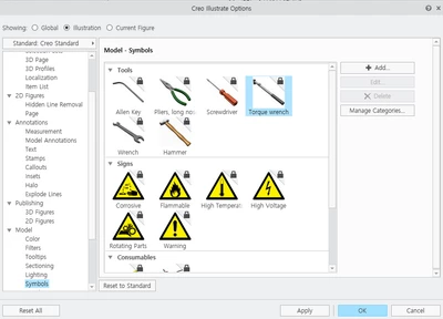

Inho_14-AlexandriteAuthor
September 8, 2023
It's marked with a padlock.
Is this an uneditable state???
agarland
September 8, 2023
So you need to use the admin tool to edit the symbols.
If you don't have that installed you will need to do that first.
Here's a link to the instructions for installing the admin tool.
Installing the Administration Tool (ptc.com)
In there you should be able to edit all symbols.
