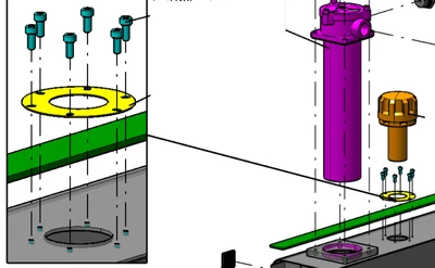

After upgrading to V 10.0 the issue struck me again. Here's an example, which pretty much speaks for itself.
The view in Creo Illustrate canvas:

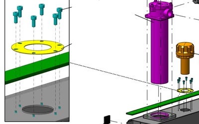

The outcome in PDF (exported as an image in PDF format with 280 dpi):
It's as if insets (and leader lines) were affected by the dpi scaling but explode lines in the canvas were not (even weirder cause they're the same entity). You can clearly see that explode lines in the inset and the leader line are scaled when being converted but nothing in the main canvas does. (It's not a 2D figure).

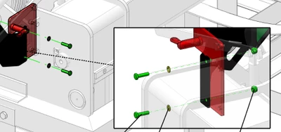

A different view, where we need to choose to either create absurdly thick in-canvas explode line for its inset to be visible or keeping its inset barely recognizeable:
