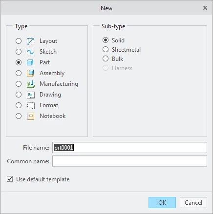

In the "New" dialogue box in Creo change the label of the "Name" field to be "File Name" since that actually what it is.  Then it will be consistent with what Windchill calls "File Name".
Secondly, change the "Common Name" title in the dialogue box to be simply "Name", again this would make it consistent with what Windchill labels "Name".  Not having these two attribute titles consistent between these to tools that are intimately integrated has caused untold amounts of discussion/confusion and mistakes.
In Creo 5.0 Name has been changed to File name
Common name is retained so that we do not confuse users especially those who do not use Windchill

Status changed to: Acknowledged
