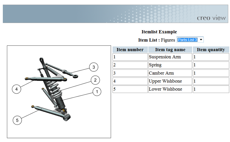

March 3, 2014
Raymund,
Here is an example of an item list automatically generated by the Creo View Web Toolkit in a webpage. The content of the item list is populated on-the-fly from the content of the 3D illustration.
