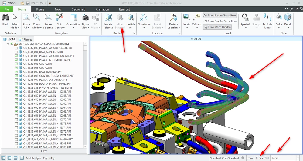

Is it possible to hide selected items when "FACES" Selection Method is selected in Creo Illustrate ?
  • May 14, 2020
  • 2 replies
  • 2073 views
Link to Case: https://www.ptc.com/appserver/cs/view/case.jsp?n=15398519
  • "Hide Selected" command is NOT allowed when FACES Selection Method is selected in Creo Illustrate.
  • Is there any other way to hide faces/selected items  when choosing FACES in the Selection Method ?
    2020-05-13_16h11_15.pngThank you in advance
Badr EL ANDADI
Best answer by agarland
No you can't hide individual faces of a part only the entire part.
What is your usecase for wanting to do this?
agarland
agarland16-PearlAnswer
May 15, 2020
belandadi17-PeridotAuthor
May 19, 2020
@agarland
Thank you for your reply.
Customer was working on an AR based on that model and he needed to hide some sequences.
We found a workaround by solidifying the original model in STEP forma and convert it into Solid Parts in Creo Parametric and this helped him to unlock the situation.
Thank you
