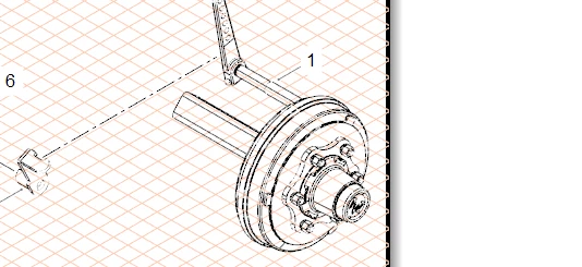

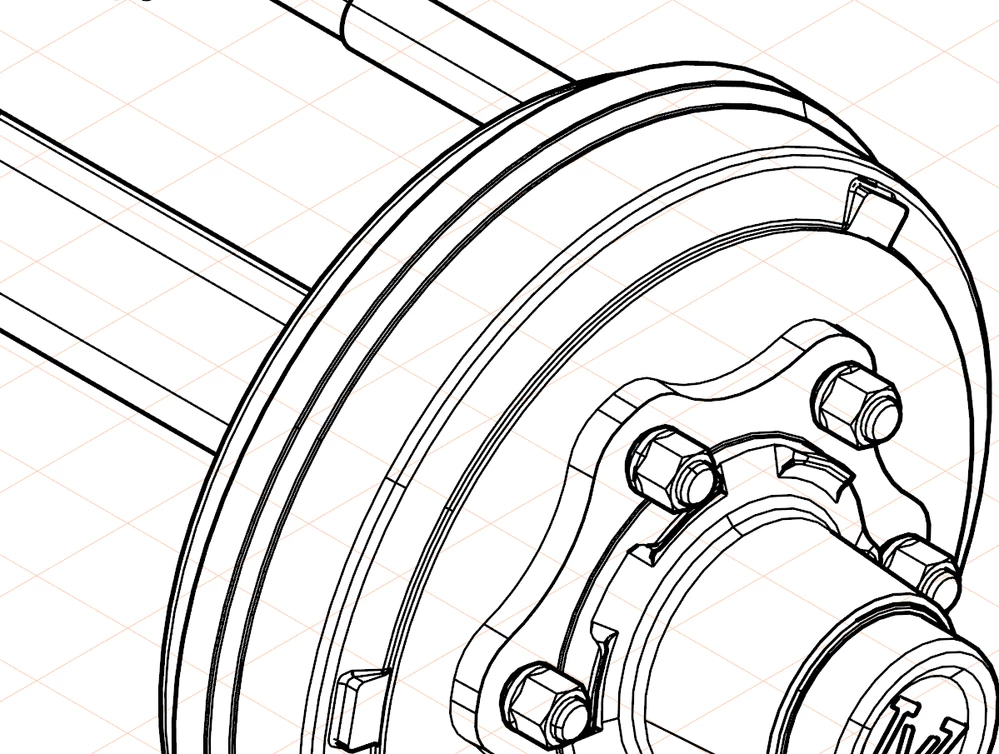

We start IsoDraw 7.3 M080 on our new NTB with Nvidia Quadro P600 and we have problem.
When I have drawing in 2D and go full page display (zoom out) the drawings get cracked.
When zoom in it works nice and fast.
We think problem is here with 2 GPU so we turn off integrated GPU in bios.
Problem is something like GPU wont work when display is bigger, somethink like saving off power.

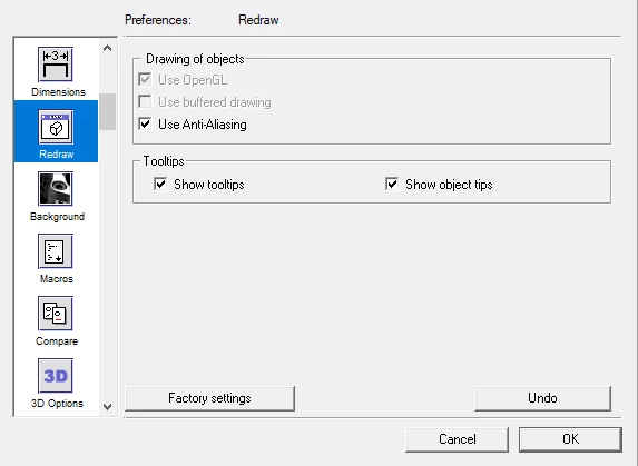

I found a solution for an issue that sounds like yours.
PTC recommended that we disable OpenGL (which also disables Anti-Aliasing).
We did not like how this looked.

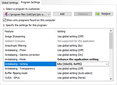

I found that the nvidia driver settings, when set to prefer "Quality" were on the low end of what our graphics cards offer, so I cranked the setting to 11 and the problem disappeared.
The biggest change came from FXAA (which is disabled by default) - enabling it immediately solved the problem, but all the lines appeared stronger.
We opted to leave FXAA disabled and instead set the Antialiasing to "64x (16xSS, 4xMS)"
