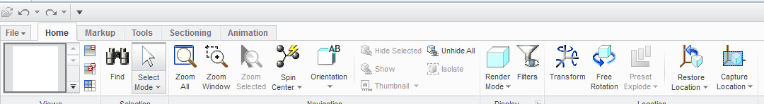

I am a product specialist for Milking Robots and Forage machines. When I want to measure up a item in diameter or length I keep stuggeling with this.
April 13, 2016
in my Creo View Express 3.1 measure tools are available on Markup tab.
To measure distance, you have to select 1-st reference, press CTRL key and select 2-nd reference.
To measure diameter, you have to select cylindrical surface and then its circular edge.
