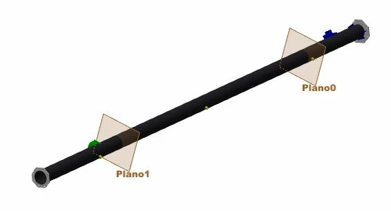

Is it possible to create multiple planar sections in a figure? I would like to show only the two ends of a pipe. I have attached a image that shows two planes (for visualization), the componentes between the planes are the ones I want to remove. I was not able to achieve this with the sectioning tab tools.
Best answer by agarland
Currently you can only create one section per figure.
I would suggest creating an Product Idea if this is a feature you would like to see.
AMartins1-VisitorAuthor
August 27, 2021
Ok, thanks for your answer and suggestion.
