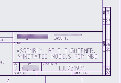

We have an additional request to display version information(Revision) of the drawing on the Creo View application
Can someone please help me in getting the solutioning part?
January 30, 2024
If you add a metadata table on the side of your drawing format in Creo Parametric, it will be shown in Creo View.
January 30, 2024
Can you please explain it little brief?
January 31, 2024
This table is part of our drawing format and is placed down by the title block. The drawing and driving model are parameter driven as well as Version and Modified columns.
