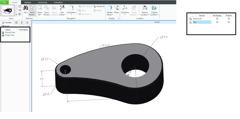

I am using Creo parametric educational licence and Creo view express free version.
1. I have created 2 combinations states in the creo parametric model and selected publish option. I can see that and edit in Creo parametric but when I export / save as to Creo view (tried all 4 extensions), The combined states are not visible under viewables section.
2. The CAD color is too dark in Creo view but it is normal in creo parametric. Can it be made similar to creo parametric
Can anybody help. Thanks in advance.

I found the answer to my first question by myself.
I changed the recipefile option (See the image)  to 1  and it worked.
File Location: C:\Program Files\PTC\Creo 6.0.2.0\Common Files\text\prodview
File Name: export_pvs
