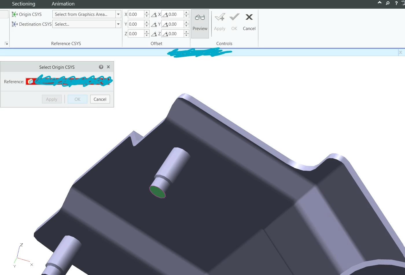

Not able to asemble parts using 'Select from Graphics area' option in CreoView.
  • June 13, 2024
  • 4 replies
  • 1851 views
I want to assemble/mate two parts together, but sometimes I am unable to select the origin and destination from the ' select from graphics area' option.
Can anyone please help me with it.
Best answer by agarland
Unfortunately if the geometry doesn't have the necessary information (axis, edges etc) the assembly tool won't be able to mate the two parts.
I'm not aware of any workarounds for this other than manually positioning the parts using the transform tool.
agarland
June 13, 2024
This is normally because the parts don't have the necessary edges or axis required.
If the geometry doesn't have the necessary edges, axis etc Creo View do the mate operation.
You could try adding an axis to both the parts you want to mate and try using that.
6-Contributor
June 14, 2024
Even if I try to create an axis for the parts, the selected edges, faces are not being taken as references to create the axis. What can I do in such situations.
P.S I used the mate operation itself in reply to your solution.
agarland
agarland16-PearlAnswer
June 14, 2024
