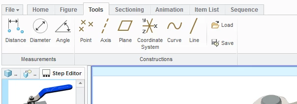

I am not able to find Assemble option and Animate key frame editor in Creo Illustrate 3.1.
I can see Animation tab, but the control tools within tab are not highlighted.
The tools tab does not include assemble option
Please find the attached file for your reference
Thanks in advance

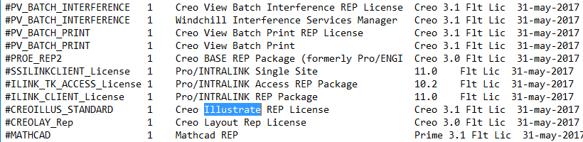

what is the name of your license ... CREOILLUS_STANDARD or CREOILLUS_ESSENTIALS ? Look into your license file.
MH
svaidya1-VisitorAuthor
October 6, 2016
Hi Martin,
It's mentioned CREOILLUS_STANDARD in license file.
Please find the attached snapshot for your reference.

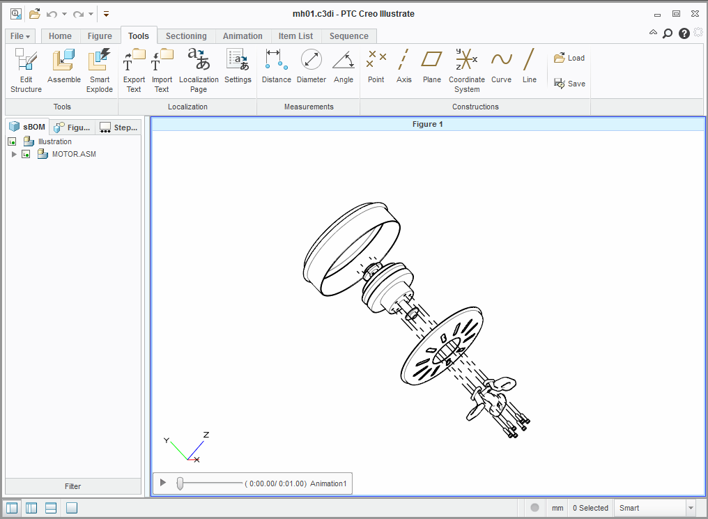

I downloaded and installed Creo Illustrate 3.1 M010 and I can see following window. I suggest you uninstall Creo Illustrate on your PC and repeat my steps.
