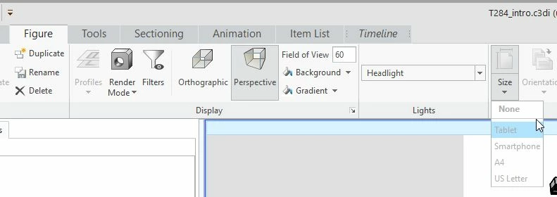

In Creo Illustrate, there is an option to turn on/off page size for a figure as long as the Figure as not been set as an animation or sequence. However, after the animation/sequence is selected, the page size control is grayed out and unable to be modified.
This locked area remains on the screen during editing as well as during export meaning any video export at a higher resolution includes a grayed out area around the entire export.
Is there a way to disable the page size without having to recreate the entire animation?
Related: is there a way to disable gnomon in animation export the same way it is in image export? Or to batch export each frame as a still image using the Save Figure As > Save as Image file?

@mwilliams-5 - Also: is there a way to set a custom page size? The page size limitations mean that Illustrates math makes awful 2D vector files when exporting something large, like a vehicle or an engine when constrained to a width of 8.5 inches.
My colleague is working on animation practices and I'd love to know the answer to your question as well, since if you cannot change it, you have to start over, and we don't have that kind of time.
