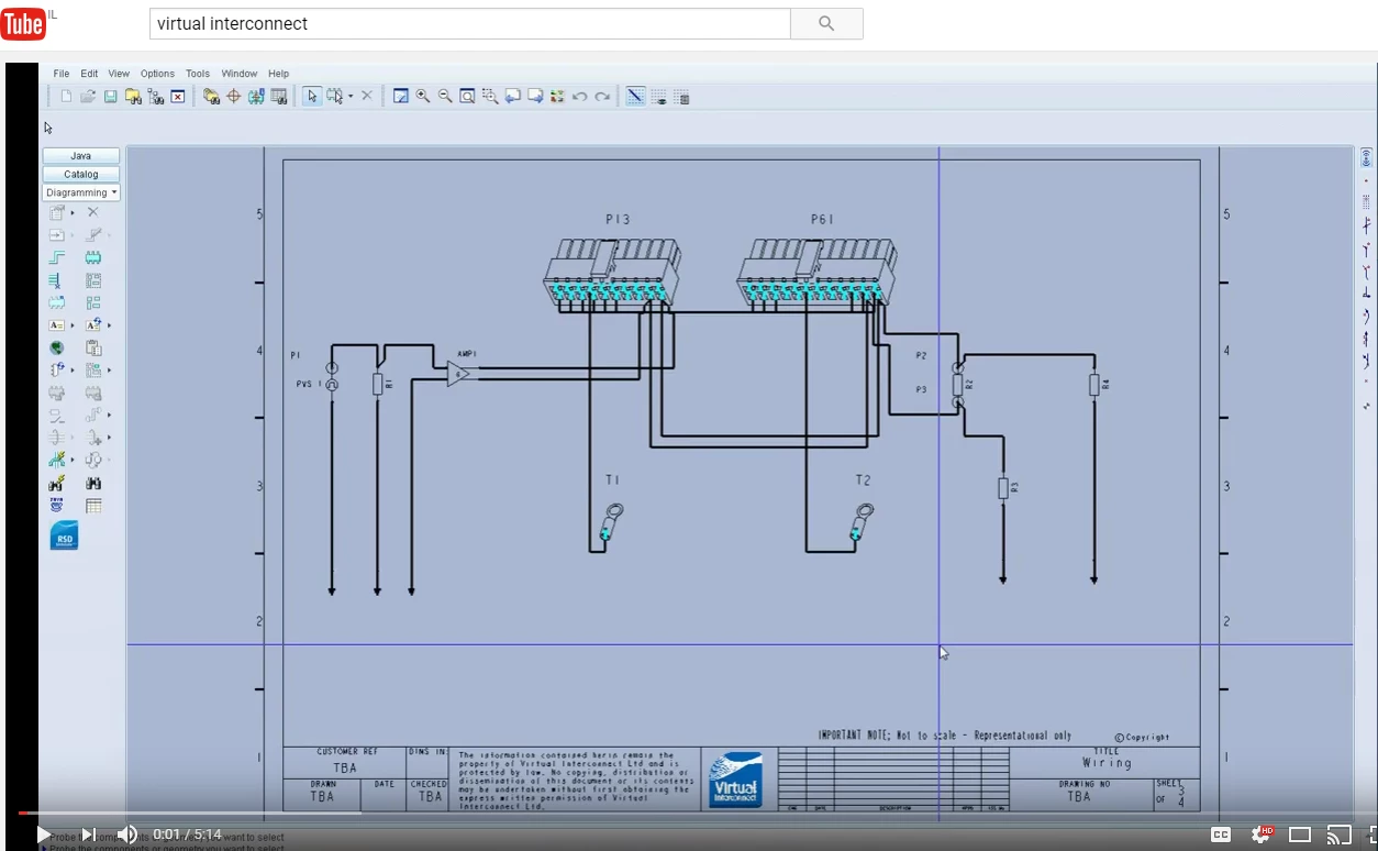

Recently i was watching the following great video, here: 3d view from Virtual Interconnect, and was supprise to see that creo schematic has a 3d view of a connector.
What is the proces to achive it ? or it is just an import of a dwg ?
Will be happy to hear your inputs
Many thanks,
November 20, 2017
You can import a .DWG or .DXF if you already have it - which is a lot easier than trying to sketch it using the tools in Creo Schematics, which are a little out of date.
