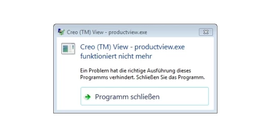

does anyone know how to re-activate a c3di file after a crash of CreoIllustrate 1.0?
I had deleted a small animation from a figure and I had already a few times the error message from Windows7-64 bit as shown in the attached screenshot creo_absturz_sml.jpg.
Today I had a similar situation in an c3di-Illustration with about 6 or 7 figures, when I had deleted a 50 sec approx. animation from a figure and then wanted to save the illustration.

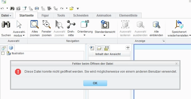

When I now want to reopen the illustration, creoIllustrate states the error message shown in the scond attached screenshot. Is there a log or a backuptool installed with creoIllustrate which might help to use the file again? Otherwise, a lot of work would be lost to Nirvana....
The text from the error message says, the illustration might be used by someone else...? But I just restarted the computer and the first action was to start CreoIllustrate and to try opening the file, so...

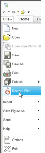

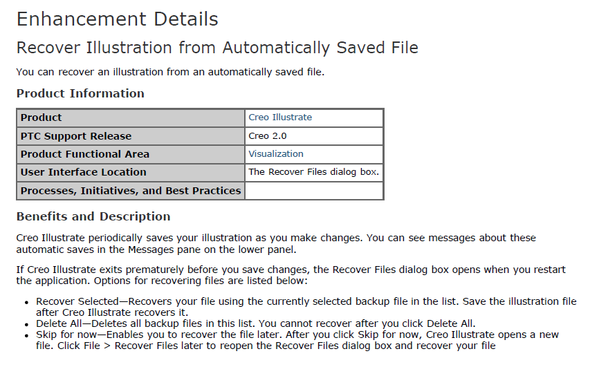

Note that in Creo Illustrate 2.0 available tools for recovering lost files after crash or premature exit.
March 29, 2012
There are functionality enhancements in this area in Creo Illustrate 2.0
Creo Illustrate now periodically saves your illustration as you make changes. You can see messages about theseautomatic saves in the Messages pane on the lower panel.
If Creo Illustrate exits prematurely before you save changes, the Recover Files dialog box opens when you restartthe application. Options for recovering files are listed below:
  • Recover Selected—Recovers your file using the currently selected backup file in the list. Save the illustration fileafter Creo Illustrate recovers it.
  • Delete All—Deletes all backup files in this list. You cannot recover after you click Delete All.
  • Skip for now—Enables you to recover the file later. After you click Skip for now, Creo Illustrate opens a newfile. Click File > Recover Files later to reopen the Recover Files dialog box and recover your file

Peter,
There is a 'lock' put on each c3di file as it is opened in Creo Illustrate to prevent 2 illustrators working on the same file at the same time. The lock is taken off when you close the illustration, but it would appear that your crash has left the lock in place.
I think the easiest solution for you is to manually copy the c3di file (copy, not move) the file and give it a new name. You should now be able to load the new file into Creo Illustrate.
Creo Illustrate 2.0 handles this type of situation more robustly and graciously.
