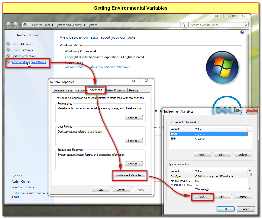

I am trying to fix the issue of drawings printing black from Creo viewer.  I am looking at Document CS94057 and under the workarounds section, it says
  • Set PV_OFF_SCREEN_SIZE_LIMIT=2048 as a System Environment Variable in the Creo View runtime environment
Where can I find the System Environment Variable in the Creo View runtime environment?

Jason,
This isn't a Creo View environment variable, but a computer variable.  You will need to access your system's properties and set it there.20151118-073957.png
