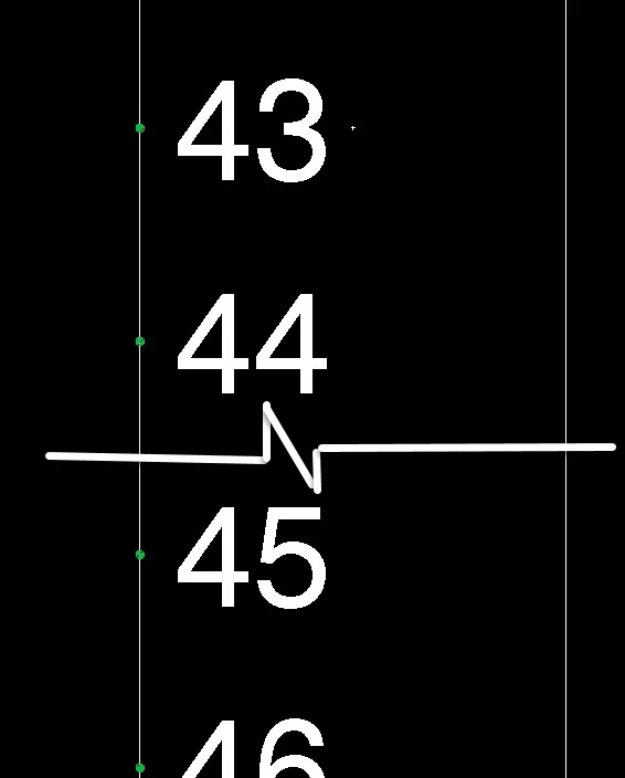

I have a connector that has 186 pins and only using 44. I want to cut the connector at the 44 pin location and delete or hide the remainder part of the connector from view. I used to be able to do that in Pro/Diagram, I'm almost sure it can be done in Creo Schematics.
Thank you
May 15, 2023
I believe by highlighting and then a right click you can select reorder members. From there you can delete portions of the connector you don't wish to show. I did this on a small scale. Hope it works for you!
