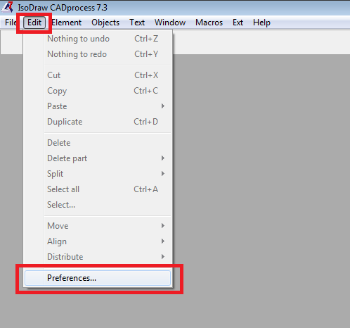

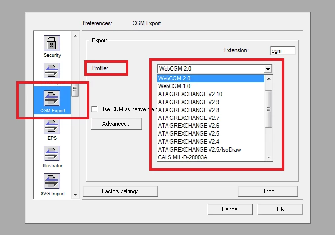

Hi Lloyd,
Please select in main program menu: "Edit" -> "Preferences" -> "CGM export" -> "Profile" -> "WebCGM 2.0" (for me In Arbortext IsoDraw 7.3 "WebCGM 2.0" format set up by default):
