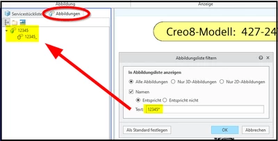

Is there a search function for Creo Illustrate figures?
In the future I will have large Creo Illustrate files with a lot of illustrations (20....100 and more), all consisting of 11-digit numbers. In order to find one of these numbers (illustrations), I urgently need a search function similar to the search function in the parts list.
Unfortunately, at the moment (it seems) there is only a filter function for figures that isolates the figure I am looking for (see picture below):

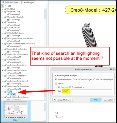

However, I would like to have the figure I am searching for highlighted in the list of all figures, so that I can see the location (see picture below):
If I am wrong, please tell me how to search for figures.

Best answer by agarland
You are correct, there is currently no way to search in the figure list.
I would suggest creating a product idea for adding search capabilities to the figures list as this could be a popular enhancement.
Adrian
