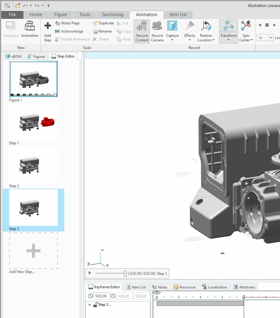

but each time I create a new figure, the sequence within my already created figure is erased. Is there a step where I need to save this? The program is behaving oddly:

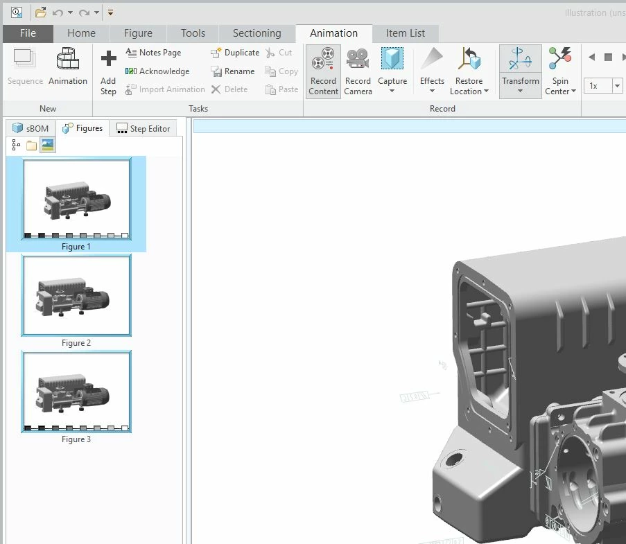

1) Create Figure 1 with a sequence of 10 steps
2) Create Figure 2, and suddenly all the steps disappear from Figure 1
3) Save a copy of Figure 1, all of the steps reappear - with all 3 Figures now having the same steps
4) Delete or add a step from one figure, and the change is reflected in the other two figures
5) Create another new figure. All the steps disappear again from the other figures (why?)

So I think what you are seeing is that the tree section of the dependency view (and folder view) have a slightly different behavior in that a single click does not open the figure.
In the tree (top section) of either view type you have to double click to open the figure.  This allows you to use a single click to move the figure in the tree or access the Right mouse button menu.
A single click in the gallery (lower section) however will open the figure as it does in the gallery view.
This may explain why you do not see the Step Editor tab appear when you select a sequence figure in the upper section (tree) of the dependency view.

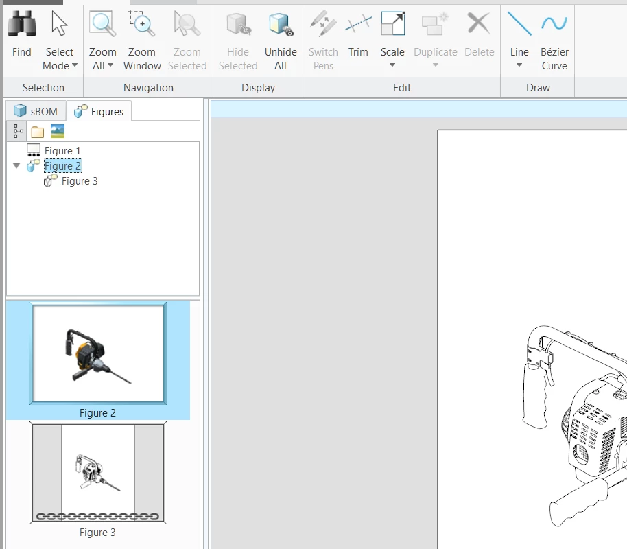

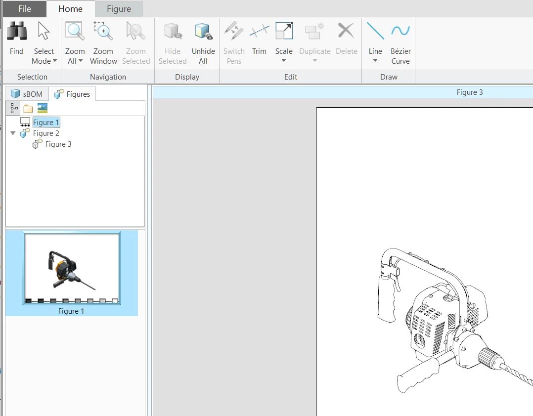

In the dependency view you will only see the thumbnail of the selected figure plus any dependents (2D figures) of that figure.  We do not show all thumbnails of all figures in the dependency view.
I've attached two images to demonstrate, is this what you are seeing?
