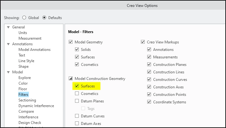

Are Shrink wrap skeleton surfaces NOT viewable in Creo View Lite? Is it better to use Stp, iges, etc.instead?
I'm trying to route some piping/wiring on a unit. But NOT having to load the whole unit. Because it seems to slow down my computer. I'm trying to share this with my colleagues via Creo viewer Lite.
Is there an alternative?

What do you see if you turn on the surfaces filter?
December 5, 2023
