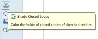

There are two very useful options in the Sketcher Diagnostics Tool, which can save you a lot of trouble:
"Shade Closed Loops" and "Highlight Open Ends"
config.pro options would be very useful to activate the two options.
Today we do it via a mapkey during startup, which opens a sketch and clicks both options on, very nonprofessional.
My proposal:
sketcher_diagnostics_shade_closed_loops     yes/no
sketcher_diagnostics_highlight_open_ends     yes/no

In Creo 1.0 and Creo 2.o they exist.
June 13, 2012
Starting Creo Parametric 1.0, set the config.pro options:
  • sketcher_shade_closed_loops yes/no
  • sketcher_highlight_open_ends yes/no
