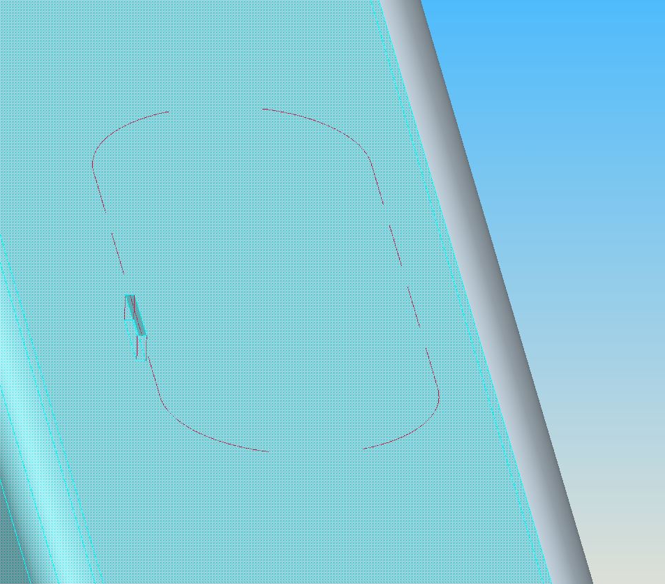

I would like to sketch a Dashed line, and after that...Thicken the sketch and extrude.
This is only possible by using the crappy Thicken featuren in Sketch mode.
OR 1 linepiece at a time and Thicken the extrude.
Multiple Lines in extrude modus are not accepted.

I want to make 1 sketch;
And Thicken-Cut-Extrude it in a Sheetmetal part
To create 'Break-Out Holes" and stuff Sheetmetal parts
BUT The sketchers NEEDS 1 Line or 1 Loop.
Multiple lines extrude in 1 feature is not possible (as far as i know).
