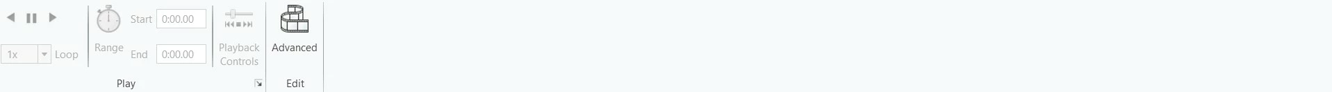

I am unable to create an animation in CreoView. I am new to CreoView and I'm not sure if we have to first create an animation in Creo parametric and then import it into CreoView.

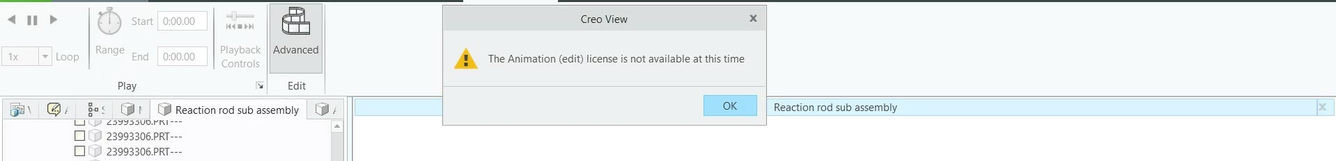

If I click on 'Advanced' option in CreoView, I get the message "The animation (edit) license is not available at this time.
Can someone please help me with this issue. This option will really help me in assembling the components together.

You will need a license to use this functionality.  If you go to file -> Options -> Startup, you will see MCAD options list.  Each of these may or may not require additional licensing on top of the MCAD license.
You don't need to create anything in Creo Parametric to create animations on the Creo View file.
