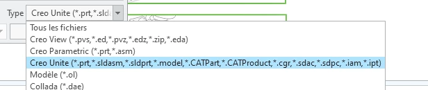

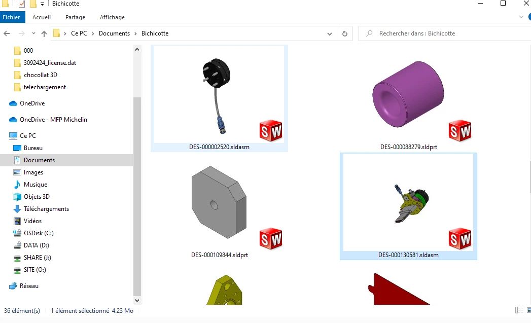

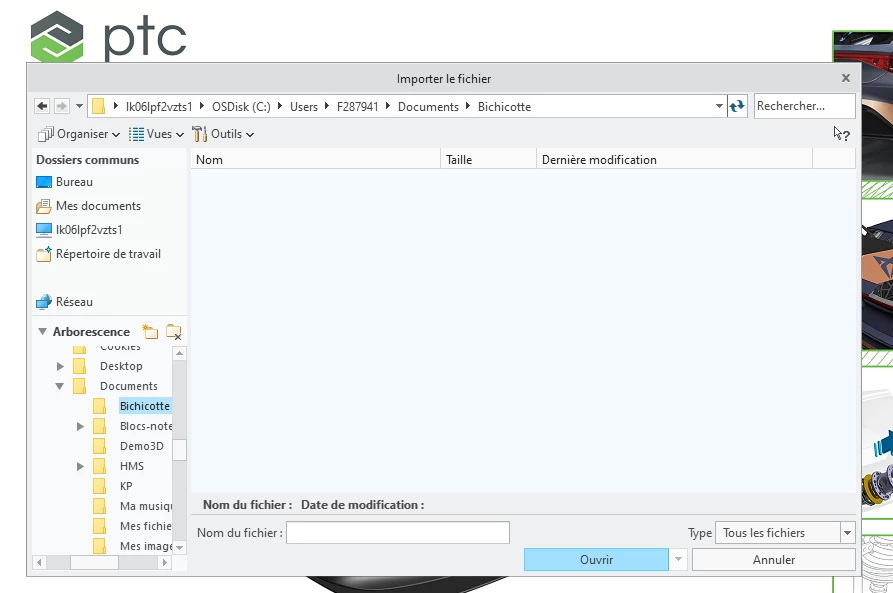

we trying to open the file with format .sldasm in Creo Illustrate but unfortunately are not able to see it during the import.
Based on this PTC Help Center . sldasm should be supported format. Are we missing something here?

Hi Olena,
It looks like you are running Creo Illustrate Standard which does not support the import of Solidworks files.
You would need a Professional license to enable those formats.
