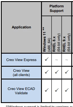

I checked the latest support matrix for Creo view and it does not look like its supported on ChromeOS:
Creo View is a separately download application which you can find here: https://support.ptc.com/appserver/cs/software_update/swupdate.jsp
I also checked future platform support and ChromeOS is not listed.
