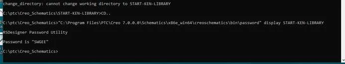

When i created my own Template file with ".rsd" & ".rsdt" file. When i create any new connector/variable connector symbol and send it to temporary submission folder and update the same in central catalogue by copy and paste.
I cannot edit/delete the same symbol neither in .RSD file or .RSDT file. am i doing the wrong move to update the same symbol which i created in template file ? or i should directly delete the symbol from the central catalogue folder ? when i tried to delete the same symbol in template file am getting the following note in below dialogue box " Cannot edit shape for central catalog item".
Please guide me how do i update the symbols in template file after i submit them to central catalogue location.
Best answer by klittlejohn
From my own notes on doing this process;
How to set a schematics design password:
Save as the design into a folder (network drive or local drive). In File explorer navigate to the location you saved design (not the folder of the design name) Open the command window (type cmd in the microsoft search window) Change to the directory that you saved the design to (not the actual design name, the level down) Copy/paste “C:\Program Files\PTC\Creo 7.0.0.0\Schematics\x86e_win64\creoschematics\bin\password” (add the quotes “”) upload_-aW1hZ2UwMDIuanBn-2650818346544108241..jpg Add the word display and the design name as shown (for displaying password name).
To set the password you use set <design name> <password>

Hi PKUMARAK,
In order to edit a shape in the central catalog requires you to use a catalog lock design that you setup a password to unlock and allows editing with that design file only.

April 2, 2024
Protecting the Base Design from Unauthorized Modification
Within the Creo Schematics installation, the system administrator can run a commandline
program to password-protect the base design.
1. Open a command window and browse to the folder where password.exe is typically
located:
<creoschematics_loadpoint>\i486_nt\creoschematics\bin
2. Enter password set <path to design—including the design folder> <password>.
In the following example, Creo Schematics is installed at <creoschematics_
loadpoint>.
The design that requires password protection is at <design_
location>Project1.
The password that is set to the base design (Project1) is Creo.
a. Open a command window and browse to the bin directory:
b. At the prompt, type the following command:
password set <design_location>\Project1 Creo
A system message confirms that the password has been set to Creo.
3. To unlock a design, open it in Creo Schematics. Click Admin ▶ Unlock catalog and
enter the password.
