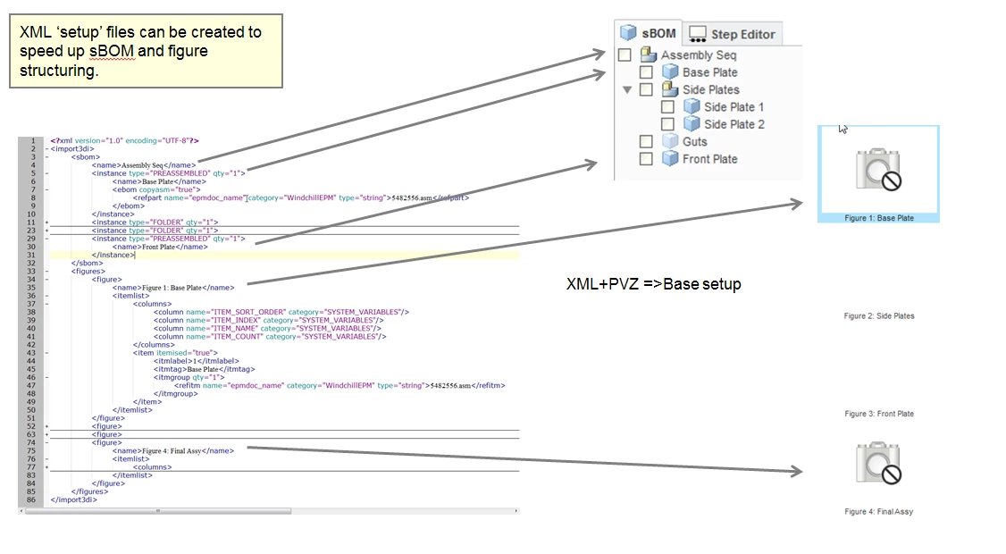

Has anyone got any examples of working practices with the use of XML files to speed setup.
I'm dipping my toes in but am wondering if there is a way of specifying what items should be shown and which ones hidden in the figure. I have tried the itemlists but this doesn't quite seem as easy as i'm imagining the base setup ought to be.
I also have outstanding questions regarding recipe files reference info with PTC tech support that don't seem to have an obvious answer yet.
