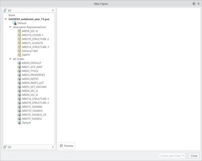

What is the way to view Creo Parametric simplified representations in Creo Illustrate?
is it possible to do it?
Can Creo parametric groups be viewed in Illustrate?

When creating a new figure you can choose a viewstate to use as the starting point for the figure.
Simp reps will be shown under the Alternative Representations.

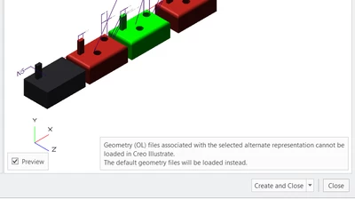

One thing to bear in mind is that currently when using a alt rep to create a new figure alternative representations of parts will not be loaded, instead the default representation will be used.
You will know if a default is being used in place of a alt rep as a warning message is displayed.
