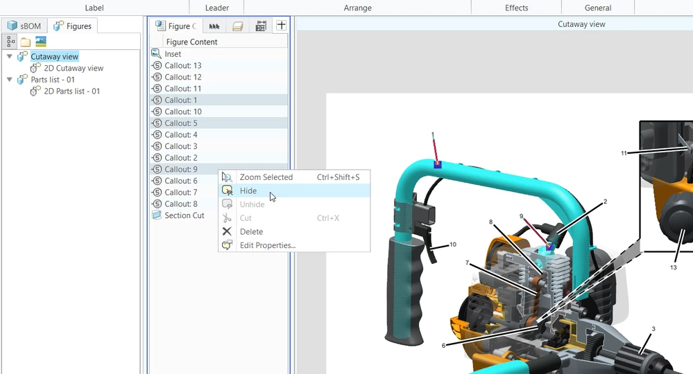

Is there a way to control visibility of callouts and notes in Creo Illustrate 7.0?
Best answer by agarland
All figure content including callouts and notes are listed in the figure content tab of the upper data panel.
Right clicking on any item will give you a menu with options to show/hide/delete etc.
agarland
agarland16-PearlAnswer
June 6, 2022
