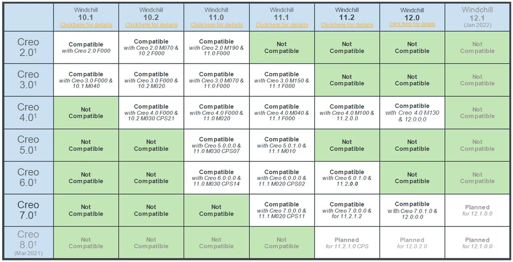

We think to upgrade CREO version from 5.0.4.0 to 7.0.0.0.
  • March 11, 2021
  • 2 replies
  • 1315 views
Please confirm CREO version 7.0 is compatible with our existing windchill 11.0
March 11, 2021
March 11, 2021
Creo 7 introduces multi-body part files and that has required changes to Windchill to support them.
I am in the process of upgrading Windchill to 11.1 m020 cps14 just for that reason.
