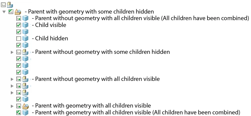

In Creo Illustrate 6.0 I can see four different checkbox icons in sBOM - see the image below. All parts are enabled in the BOM. I cannot find explanation for them anywhere. Could you explain what do that four icons mean, please?
Thank you!

Hi Marcin,
Here's a breakdown of the sBOM checkboxes.
Hope this helps.

Hi Marcin,
Hope this helps.

This is absolutely brilliant, thank you!
