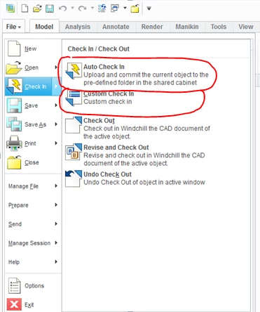

Hi All,
Whenever we do a model or drawing check-in, which type of check-in should be used ideally so that we can see updated images in Creo View 2.0 ?
There are 2 options available Auto check-in and Custom check-in.
What is the difference between both of them?
Thanks.
Shridhar
September 17, 2014
Custom check-in steps along the way so that you can set the destination folder on new parts for instance. Automatic takes the default for every check-in option, so a new part will go into the root folder of the container that is associated with the workspace. Automatic is usually fine when working with existing files, Custom will take a few extra mouse clicks for existing files.
