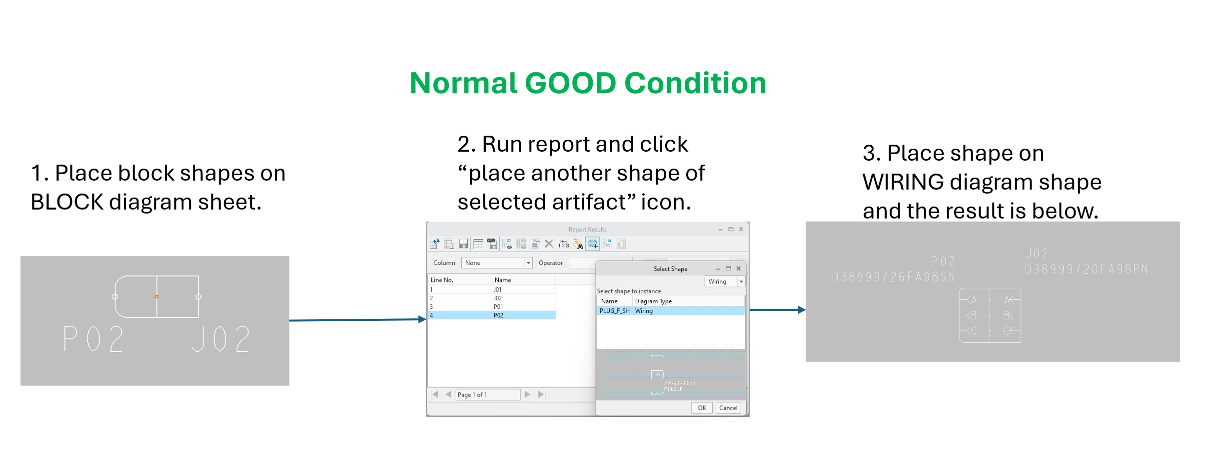

In Creo Schematics 11.0, when placing a Block shape on a block diagram sheet first, run a report, select place artifact, and then place the Wiring shape on a wiring diagram sheet, the software does this properly.

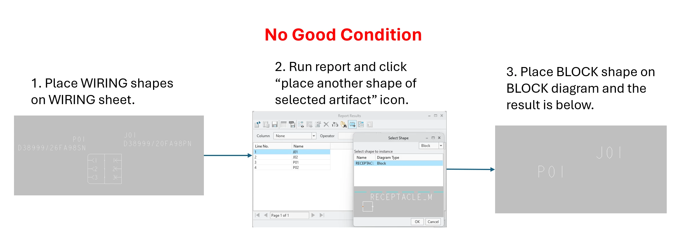

When you have a wiring shape placed first, and then place the block shape next, the software does not show the block shape of that artifact. Only the label is displayed, but the shape's outlines are not displayed. I can click and drag/select the artifact and the properties can be seen in the parameter panel. I have tried updating all sheets, restarting the program, but still does not display. No Error is displayed.

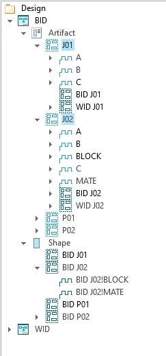

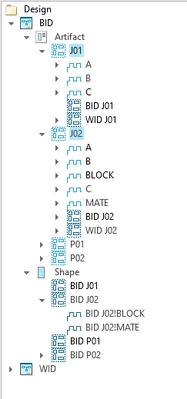

Not sure if this has anything to do with it but when I look at J1(NO GOOD) and J2(GOOD) in the model explorer, J1 does not have the 2 block ports (for this shape the ports are named BLOCK and MATE) but J2 does.
