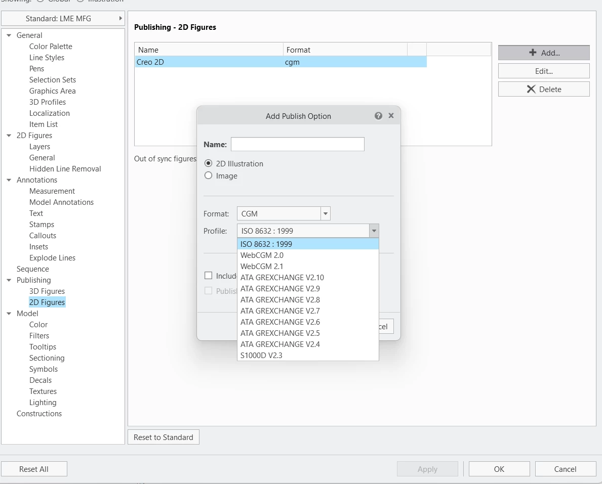

Creo Illustrate - EXPORT to CGM missing Profiles like S1000D
  • Include which software and version you are using!
    • Creo Illustrate 12.1, but any other version missing it too
  • Explain what you already tried.
    • I miss some of the CGM export profiles, compared to ISO DRAW
    • Does anybody else having same demand for e.g. S1000D in Creo Illustrate
  • Include a screenshot
    • Compare Iso Draw 7.4 vs. Creo Illustrate 12.1 Help center
    • All not marked missing, especially the S1000D is my demand

Hello, Looks like the Export Standard for S1000D V2.3 already found it way into PTC Illustrate 2027!
So this Post / Demand is completed / done.
Our affected Dept. will test this … but think it’s work as defined within the Spec S1000D

"To simplify the UI and reduce the complexity of the CGM export module, we have included or considered only the profiles that have shown significant usage in the past couple of years for Creo Illustrate"
