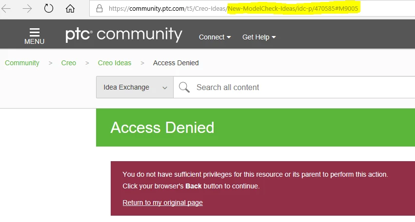

TomU
Apr 9, 2018 3:27 PM UTC
It seems like it still exists but is locked behind some type of wall.  Maybe @Jaime_Lee can help figure out why...
Jaime_Lee
Community Manager
Apr 12, 2018 11:49 PM UTC
Hi, @TomU
Thank you for bringing this to my attention.  Creo Ideas are under review.  I will have to address this after the content remapping is complete.  I have this issue bookmarked.

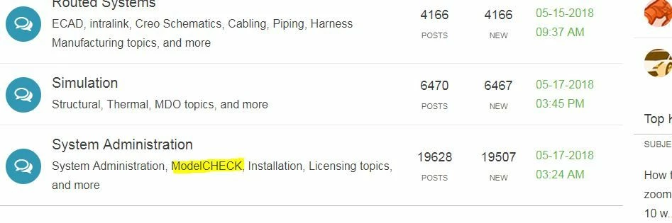

May 17, 2018 7:54 PM UTC
I still can't find the specific forum for ModelCheck.  I did a search for it and all the posts seem to be scattered in different forums.
Are we going to get this one back at some point?
May 17, 2018 8:16 PM UTC
ModelCHECK is supposed to be under system administration, according to the descriptions under the main Creo Parametric page:
https://community.ptc.com/t5/Creo-Parametric/ct-p/creoparametric
If you're asking about the ideas page, I'm not sure.  It got moved somewhere while they sort out the new ideas page(s), but the link that @Jaime_Lee posted in the Community Refresh section (not open to all) was broken and she hasn't posted a corrected one yet.
May 17, 2018 9:34 PM UTC
Found it.
It's under the PTC Work Groups.  It's listed as ModelCheck Working Group.  But you have to be accepted to it.
