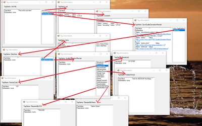

And your 'updated xml file' is NOT a valid xml file, apart from the fact that it's a picture of file contents.
Here's a picture of (part of the) structure and data of your original file:
(Start at the top right).
