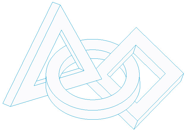

For this second Creo Parametric CAD modeling challenge, you will be creating a full sketch of the FIRST logo. You need to know basic Creo Parametric sketching tools for drawing and editing. It is a fairly simple sketch to create, but you will need to master Creo Parametric's Ellipse and Delete Segment commands to get it done right.
HINTS
  • Simplifying the display to remove dimensions and constraints will really help out with this one.
  • Try using the Shift button to sketch geometry without snapping to existing geometry and references.
  • Draw the full shapes first and then using Delete Segment to cleanup the intersections.
Extra Credit
  1. Sketch the whole thing freehand, using the attached image as a reference
  2. Add the attached image to a datum plane for some quick tracing (View, Model Display, Images)
