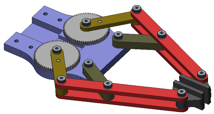

For this fourth Creo Parametric CAD modeling challenge, you will be creating a full assembly of the robot gripper shown below. You need to know basic Creo Parametric assembly constraints, Kinematic constraints and assembly structure to complete the design. It is a complex model to create, but you will need to master Creo Parametric Pin constraints to make it work correctly.
HINTS
  • Assemble the gripper plate first and make sure it is grounded
  • Add all the hardware at the end
  • Create one side first to make sure it works as desired
  • After placing the gear, add a second constraint (Slot) using the curve (blanked on layer) to control the range of motion
  • Use a Parallel constraint for the gripper_tips to make sure it does not ground (fix) the whole model
  • Watch a video of the mechanism motion
