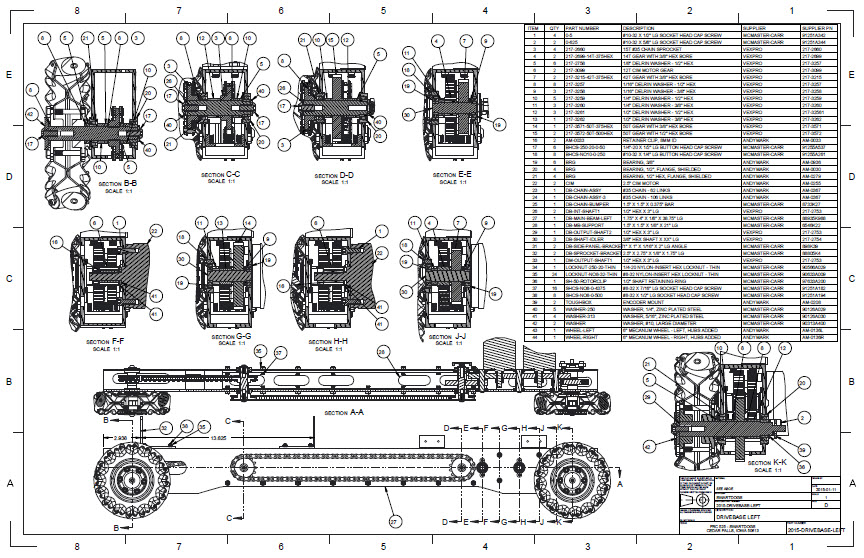

Creo Parametric CAD Modeling Challenge
For this sixth Creo Parametric CAD modeling challenge, you will be creating a detailed drawing of a complete assembly model. You need to know basic Creo Parametric drawing capabilities, along with some advanced capabilities to complete the drawing. It is a complex drawing to create and you will need to master Creo Parametric drawing annotations to complete it.
HINTS
- Use a BOM table to identify all the components in the assembly
- Use BOM Balloons to identify all the components in the drawing views
- Use Snap Lines and Cleanup tools to organize and arrange items
- Use the attached FTC robot or use your own assembly
- Make sure you have configured Creo with the "Schools Configuration" to access formats, notes, tables, etc.
Sample drawing courtesy of FRC525.
Extra Credit
- Try using BOM Balloons with QTY
- Add custom parameters to your models and show them in the BOM
- Use detail views, cross sections and other methods to describe your model as accurately as possible
