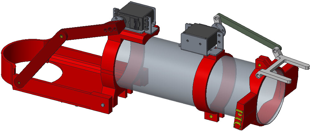

Creo Parametric CAD Modeling Challenge
For this seventh Creo Parametric CAD modeling challenge, you will be creating a fully mechanized assembly of the FTC game piece manipulator from FTC Team 5828 - E.M.P. Chaos. You need to know basic Creo Parametric assembly constraints, Kinematic constraints and assembly structure to complete the design. It is a complex model to create, and you will need to master Creo Parametric Pin constraints and limits to make it work correctly.
HINTS
  • Use Creo Parametric 3.0 (the models cannot be opened in Creo Parametric 2.0)
  • Do not allow constraint assumptions, all fixed models must have their rotation defined
  • Complex connections will require more than one set of constraints
  • Watch the robot in action in this video
  • Set rotation limits where required to restrict the motion
  • Open the Creo View model for hints
Assembly Structure Hint
GAME_PIECE_TUBE.ASM
  • TUBE.PRT
  • BIG_DOOR.ASM
  • SERVO.ASM
  • TETRIX_739197.PRT
  • UPPER_BIG_DOOR_ARM.PRT
  • LOWER_BIG_DOOR_ARM.PRT
  • SMALL_GATE_SERVO_MOUNT.PRT
  • SERVO.ASM
  • TETRIX_739197.PRT
  • HORN_ARM.PRT
  • SMALL_GATE.ASM
  • SMALL_GATE_ARM.PRT
