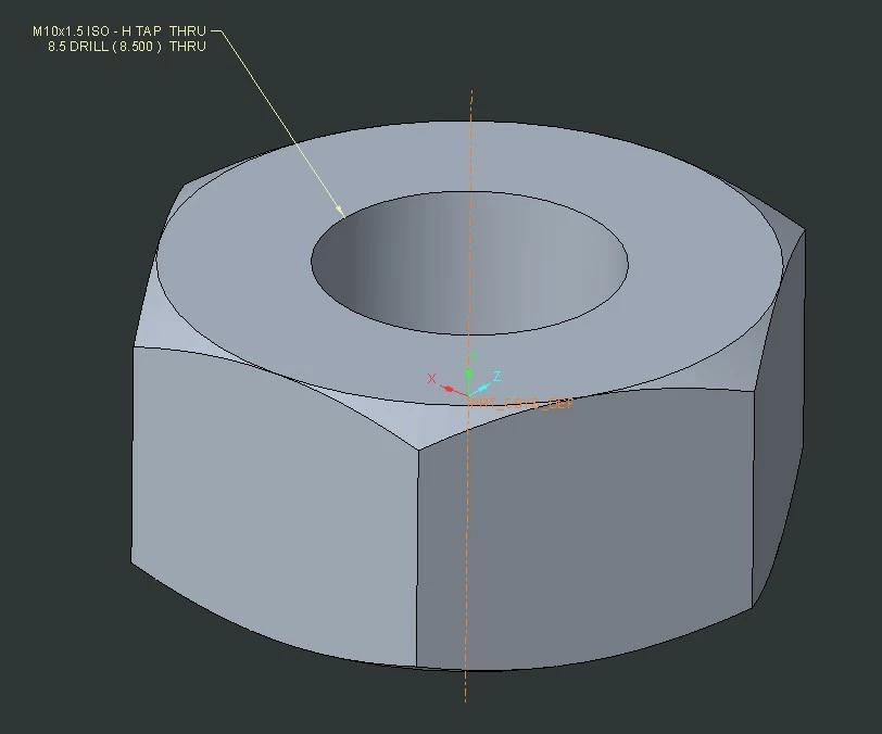

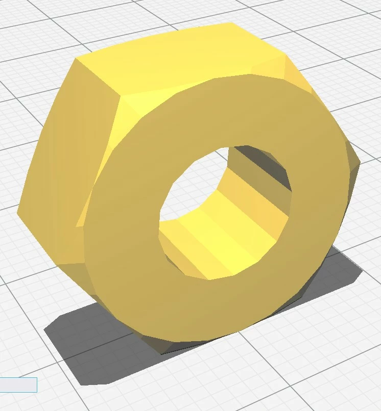

Good morning, I would like to print a simple model exported in STL and modelled in Creo Educational 9 but I would like to understand how to increase the mesh detail, how can this be done? Thank you very much

Lower limit for Chord height is determined by absolute Accuracy value. This means you need to set lower Accuracy value if you need to get finer triangles.

It's fantastic! really thank you😊
