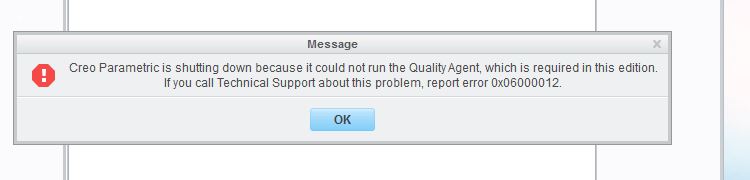

About Error after Installing Creo 2.0 student edition
  • July 31, 2014
  • 1162 views
after opening creo parametric its showing the message below and closingerror.JPG
Best answer by MarkCheli
Hi!
Please download and run the following file, it should fix this problem.
http://apps.ptc.com/schools/references/creo2_qualityagent_fix.exe
If it does not, please let me know!
MarkCheli5-Regular MemberAnswer
August 5, 2014
Hi!
