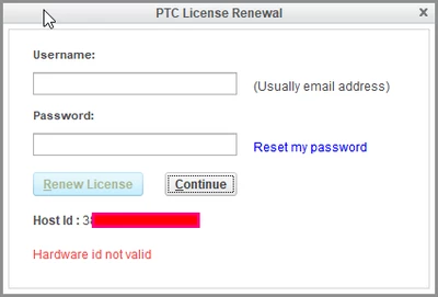

My Creo 4.0 license has expired. When trying to renew the license error "Hardware id not valid is given".

maybe Host Id displayed in dialog box is related to virtual network card. Check output of ipconfig /all command.

The host ID in the dialogue box is the same as the MAC adress of my ethernet adapter. (ipconfig /alll)
I am however connected withe a HP port replicator but trying to renew the license with out without connection with the port replicator makes no difference.

disable all network adapters but Ethernet.

I also get the error message "Hardware id not valid" when trying to renew my Creo 4.0 license. Were you able to resolve this issue with support back then? Would be grateful for a tip.
