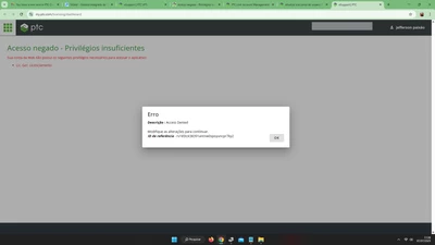

Access Denied - Insufficient Privileges
  • July 7, 2025
  • 3 replies
  • 529 views
Acesso negado, privilégios insuficientes
Sua conta da web não possui os seguintes privilégios necessários para acessar o aplicativo
Catalina
Community Moderator

July 7, 2025
Eu uso licensa de estudante e precisei trocar de laptop, ao fazer a troca e tentar reinstalar o software no novo laptop nao estou conseguindo gerenciar a licensa.
July 8, 2025
AFAIK student cannot use PTC web pages to move his Creo license.
You can install Creo on new computer and enter the product code used on old computer.
If this procedure does not work you can request license file via email. Please read https://community.ptc.com/t5/PTC-Education-Forum/Creo-Parametric-9-0-Student-Edition-Licence-error/m-p/897846 discussion.
