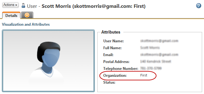

    Okay, I didn't let this one drop. Can you please try again? User management at PTC and its connection to the various Windchill systems is a bit complex. I have been working with PTC IT and they have come up with a solution today.
    All the users on your project team should belong to the "First" Organization as shown in the image below. As long as they are in the "First" Organization, you should be able to find them right away now.

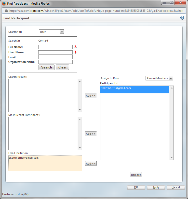

    Students can give themselves any name they want in their PTC account, so its not always easy to find them. Best method is to simply add them all by email address. Either get them in a room together or have them all send you the email address they used for their PTC account.
    If students, mentors, teachers, etc. are creating new accounts, be sure they use the "Academic" option for their account. This will let them chose their academic program of choice, FIRST, to make sure they have access to all the right content.

    Don't search. Just enter their email address directly. If you send me a PM with the addresses you cannot find, I can look into it for you. The search should work, but I am so used to just adding people by email address, I just don't ever stop to use it.
