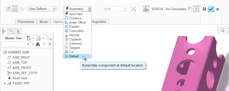

    The process is quite simple, But the main thing is that you need to put the first component in the assembly as Default. This way all the components may move related to the first main component.
    After this you assemble all the parts, go to Mechanisms and place the Servomotors.

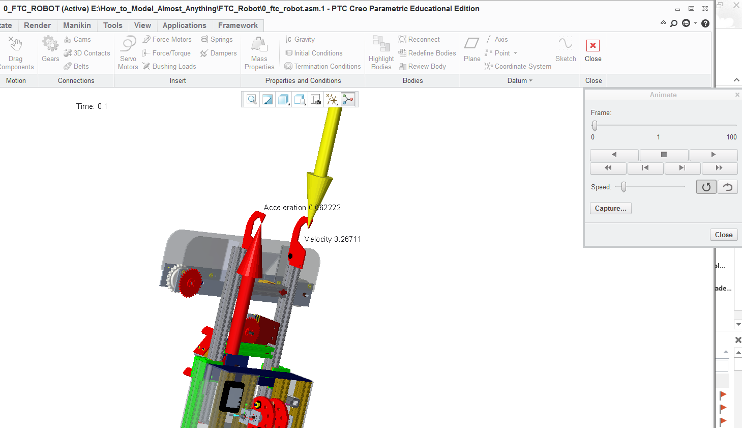

    Create the analyze (Position if you are only interested in the moves, Kinematic if you also would like to see the velocity and acceleration involved). Run the analyze and then you can place some Measurements and see the velocity/acceleration or position in graphs and also add the forces as vectors during playback.
    For a reference you can see the K-12 Software Training | PTC
    In How to Model Almost Anything Exercise 6 are all the information about Mechanism assembly and Exercise 3 is giving lots of information about the Analyses using Mechanism. Also see Exercise 11 - about the Dynamic Mechanism analyzes.
