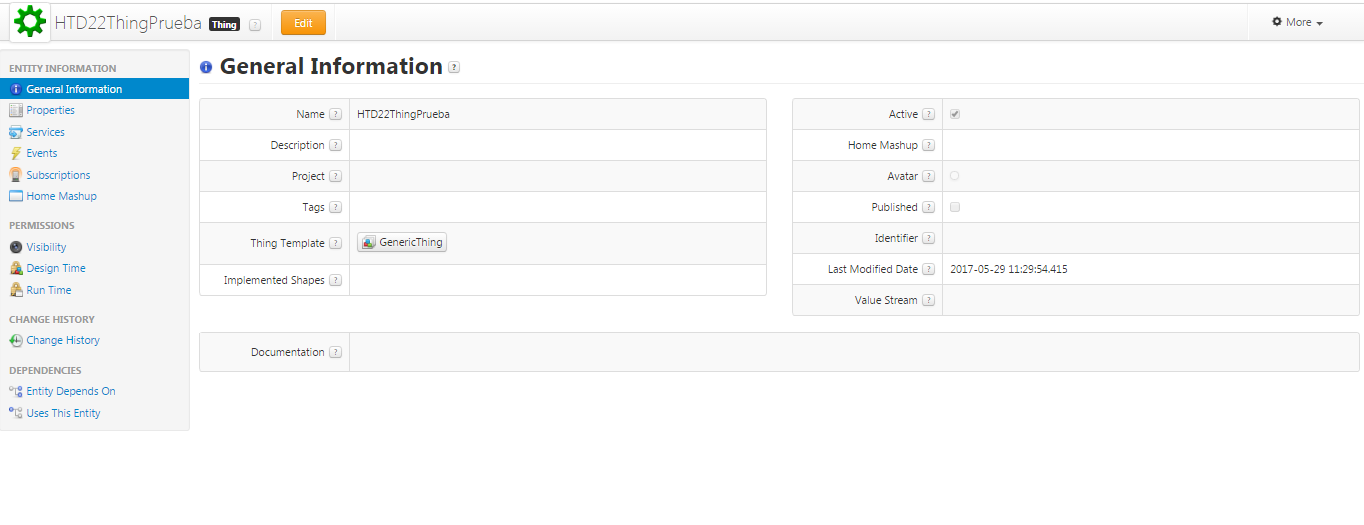

Hi I have a problem, I have connected 1 temperature sensor to an Arduino card and I want the data to be recorded in a thing, the connection is made but in the properties there is no value, attached screenshot to see if I can support

Have you checked this guide?
Weather App with Arduino Uno
