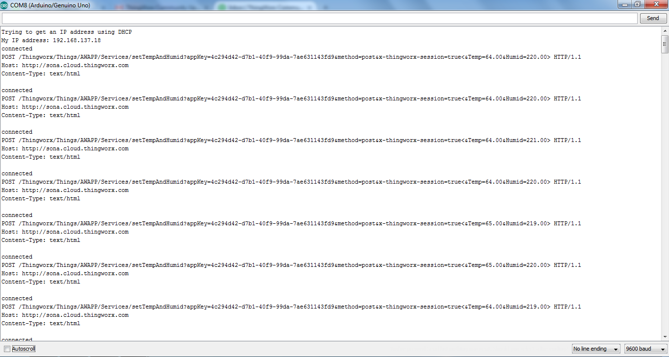

I have this issue while implementing my first arduino IOT program. after completion of all the steps successfully i haven't get the values in my thingworx server.
connected
POST /Thingworx/Things/AWAPP/Services/setTempAndHumid?appKey=4c294d42-d7b1-40f9-99da-7ae631143fd9&method=post&x-thingworx-session=true<&Temp=48.00&Humid=178.00> HTTP/1.1
Host: http://sona.cloud.thingworx.com
Content-Type: text/html
i am using thingworx 5.2.0.437.
I don't have anything in subsystem configurations

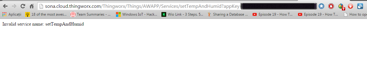

I tested your code on my thingworx hosted instance and it worked nicely. Change your server variable from http://sona.cloud.thingworx.com "; to sona.cloud.thingworx.com. Http:// is not part of the server name.
Also I noticed that the rest call for your instance is no longer working in the browser
Did you delete the setTempAndHumid service on your AWAPP Thing ?
If so, please follow the tutorial to recreate it again and run the sketch with the changed value for your server variable. Let me know if this fixes the issue.

Your Rest call is correct. I have tested it in the browser and the properties were set correctly. You don't need any additional configuration on ThingWorx 5.2 to allow rest calls. Are you connecting your board through an Ethernet shield or a WiFi shield? What code are you using for making the rest call?
Veronica

I am using Arduino Ethernet Shield only.
this is my code

And this is the Serial Output
It shows that the values were constantly updating to the Server.
But I can't See any updates in property values.
Please help me.
With regards,
Gopi

it is working fine now. Issue is with the Host address only. Thank you for the support.
with regards,
Gopi
